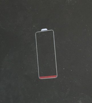

You're holding an iPhone in your hand and pressing on the power button to no effect, what is your next step?
Step One--Is this No Power? Or just No Display?
At first glance, what seems like a no power problem--the phone shows nothing on the screen--could actually be just a display problem. Many things can cause an iPhone/iPad to lose it's backlight--water damage, cheap screens with exposed solder joints at the backlight flex, shorting the backlight circuit accidentally by using metal tools while the phone is under power.... For more info, read Backlight 101.
Sometimes the phone can have the backlight on, but show no image. Remember--the backlight circuit is separate from the image circuit. No image is most commonly tool/fingernail damage near the display connector which have popped off a data filter from the board.
It is relatively easy to differentiate a display problem from a true no power problem. With no display, the phone is technically on, you just can't see anything. Connecting the phone to the computer will tell you if it's on or not. If the phone is recognized by iTunes for example, it's on, but you have a display problem. If the phone is not recognized, then it is true no power.

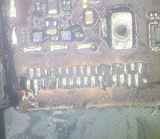

The replacement of the U2 chip is a big ol' PITA. The chip is encased in underfill and shares a border with the CPU in the iPhone 5. Many talented microsolderers can replace this chip on a case by case basis, but as of now, it doesn't seem like there is a robust way to roll out a feasible general service to address this common problem. So for now, U2 problems (at least in the US) largely go unsolved.
This underscores why it makes sense to pay attention to history and follow an efficient plan. You don't want to get caught soldering in an iPad mini charge port to replace one with no visible damage, when the iPad mini was used with a non-Apple car charger----right?
Above: An iPad mini botched charge port job--this mini never needed a new charge port. It's problem was a single filter next to the battery connector that commonly gets flicked off during screen replacement and causes the device to appear not to charge. A quick microscope evaluation would have revealed this.

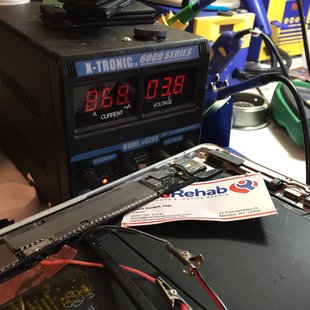

CASE 3: iPad 4 no power/dead
Another repair buddy posted on a forum wanting to know who could get him an iPad 4 battery ASAP with overnight shipping. Immediately, I thought "oh man, this is going to waste some time and money--it is U2." From what you've learned here, tell me---Why would I think that?
Most of the time when an iPad 4 is going to come in stone dead it will arrive unopened. This history eliminates any chance of 'technician damage' on the board, leaving only chip-level defects as a possibility for a no power/no charge issue at the board level.
I knew that my competent friend would have already ruled out the easy to replace charge port before thinking about seeking to have a new battery overnighted. Most solvable charging problems for iPad 4 will be a damaged charge port, and I guessed that he tried a new charge port and it didn't solve.
Why not just a bad battery? The likelihood that the battery just dropped dead one day is low--the iPad 4 isn't that old. It would be more typical for the battery to decline over time. The customer would have come in with a working iPad and complaining about poor battery performance. The shop owner would have ordered a battery and told him to come back and schedule installation. A stone dead iPad 4 is an excellent candidate for U2 ic damage--which would create a crisis. One day the iPad is fine. The next, the chip gets burned and it has a sudden onset of no charge. The iPad runs down and at the end of that day is a brick, trapping all the data that is on it and creating a sense of urgency.
A new battery might bring the iPad back enough to suck some data off, but it is unlikely to solve the underlying problem. I advised my buddy to invest in a DC power supply to manually force a little charge in the existing battery to get the data off and troubleshoot no display vs. no power vs. no charging.
A few days later I get a call asking about U2 ic replacement....
