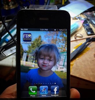

A few weeks with 100% success on my bga repairs, and I graduated from the small U2 ic chip to the bigger PMIC chip on the iPhone 4. I did an iPhone 4 data recovery job, and then while I had the iPhone 4 stuff out, I thought-----I wonder if I could get that original "toilet phone" working again. I had tried and failed many times.
The original repair story for that phone went like this:
Girls flush phone.
I sledgehammer toilet on the lawn to retrieve phone.
Rice (I was a fool!!!)
Cleaned board with alcohol, new battery and dock connector.
Board turns on, but won't charge
Head to iFixit.com and learn about the charging coil on the board (Thanks OldTurkey!)
Decide to learn microsoldering--how hard can it be---and order the AOYUE 968+ (which is not a great tool, btw)
Spent a year or so with Filip Pusca online (find talented Filip at www.iTesla.solutions)
Tried to change the charging coil on this board--it didn't go well. I didn't know enough to use a tiny nozzle, and had too low heat/flow--I roasted that board trying to get off that coil.
Replaced the coil and board was now dead---I burned the PMIC while making board s'mores
Put it aside for a few months and came back--tried to replace the PMIC.
Replaced it kinda/sorta, but now the Skyworks chip got hot and phone registered a full short.
Made some jumper from a local component by the coil---because I was too dumb to realize that you can revive a corroded pad, it doesn't mean that the pad is gone.
Put it aside.
Until tonight. Still working under the theory that motherboards are just fancy lego projects, I....
Replaced PMIC with a new one
Removed Skyworks chip and replaced with one from a donor board
Replaced charging coil again
Replaced a few local caps, including the one with the unecessary jumper.
Put back together and.....
THE TOILET PHONE WORKS! FINALLY!
It is alive, it charges, it is working!
