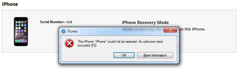

I am thrilled to see widespread attention finally coming to the Error 53 plague. Since I made my "Error 53, Let's Talk" YouTube video, I get anxious requests from stunned users for help solving error 53 every single day. For most people, there is no solution. Their previously working phone was intentionally bricked by Apple with no recourse, in the name of "security"
What is error 53?
Error 53 is triggered at update/restore of the device by iTunes. The software queries the phone for the presence of the original fingerprint sensor that was coded to the logic board. If it gets no response---error 53. Phone is bricked. Unusable. No recourse.

The kernel of truth in the articles is that yes---at update an iPhone 6 will check for a signal from the original fingerprint sensor that is coded to the logic board, and if it does not detect that signal the phone will brick with error 53. It is a simple check "hello fingerprint sensor xyz, are you there?" if "yes I am here" is not received---the phone bricks.
What it does not do is "check all parts to make sure that the phone hasn't been tampered with" or "check for third party parts and disable the device for security"
What can lead to the fingerprint sensor not giving the "yes i'm here" message?
The less common causes are a tear in the "long flex" that conveys the fingerprint sensor cable data to the CPU, a simple malfunction of the fingerprint sensor in a never opened phone, or minor liquid damage that enters at the home button and takes out the fingerprint sensor leaving the rest of the phone intact. Additionally, we have people that simply wanted a customization and changed a black home button for a white one or vice versa, or people that had the clicky plastic piece fail on the original home button so they replaced it.
The most common causes are that the home button was damaged during a DIY screen change, and was subsequently replaced. Or, someone who was not aware of the importance of preserving the original home button at screen change used a 'convenience screen' as a part. Convenience screens have largely disappeared from the marketplace, but were used in the past by some franchise cell phone repair stores because they are faster to install. (Franchise stores tend to be plugged into their own corporate engine and are the last to become of aware of trends in device problems compared to the rest of the independent repair community that is in constant conversation.) The new convenience screen comes with a new home button, proximity sensor, front camera and ear speaker so that these small parts don't have to be transferred over from the original screen--this saves time and makes the repair easier for less experienced techs. For example, the few Apple Stores that are actually allowed to do in-house screen replacements use these convenience screens. Of course they have a proprietary secret weapon--a machine that with a few button clicks can tell the CPU "hey, you got a new fingerprint sensor, forget about the old one" I love how my Apple authorized store asked for access to this device. Apple's response "Oh, you'll never see it."
Is a phone with a new home button less secure?
No. Aftermarket home buttons have no fingerprint sensor at all. They are just home buttons. A phone with a new home button will simply have anything related to touch ID greyed out, the sensor is not there. It cannot be accessed by Touch ID of the button. Apple Pay will not respond with the fingerprint. The phone is still secured (if the consumer wishes) by the passcode lock just as all phones. If the phone is stolen, it cannot be reset and activated without the original owner's Apple ID and password--i.e. it is protected from theft with the iCloud activation lock.
But it will work. Indefinitely. You can enjoy all the other functions of the phone. You can call, and text, take selfies, connect to WiFi and check email. You can play Candy Crush and FaceTime and surf the internet. It is a perfectly functional phone, no different in any way from say, my iPhone 6. I think touch ID is annoying and I've never even set it up. I choose not to use that feature of the phone.
But then one day you click "ok" in response to Apple constantly bugging you to update your iOS. The result? The phone chugs along and then fails to update with error 53. You can not go back in time and 'undo' this failed update. Your phone will boot to recovery mode and there is no escape. The special pictures you took that morning are gone. Your notes and grocery list are gone. The phone you paid $700 for is now a complete brick. The phone itself has no hardware defect, it simply can't answer the question from the CPU with "yes I am here" from the fingerprint sensor chip. There is no recourse. Apple has intentionally bricked your working iPhone 6.
