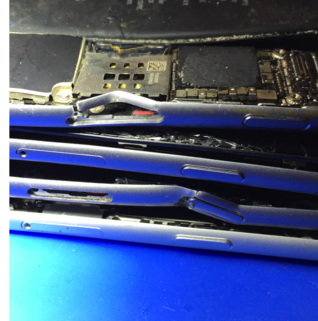

Remember when the iPhone 6 first came out and users around the world were pulling their new phones out of the back pocket of their Levi's to find it now curved in the exact contour of their ass? #Bendgate?
That little problem was quickly put to bed by Apple's PR engine and there was a switch made to a more durable aluminum for the housing and life went on.
But the fact remains---compared to earlier iPhone models, the iPhone 6/6+ is kind of a "bendy" phone. Its slim form factor and larger surface area subject the logic board within the phone to mechanical flexion pressure that no other iPhone has had to deal with.

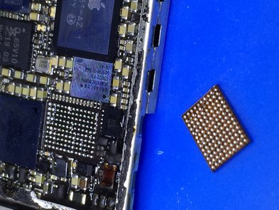

On a relatively simple circuit board this should be no big deal. Basic chips are securely anchored to the board with metal feet soldered to large pads, and this architecture could probably survive a drop off the top of the Foxconn building, safety nets or no.
But as the demand for high-powered functionality has increased, and circuit board 'real estate' has diminished to accommodate huge batteries, the use of complex ball grid array (bga) chips dominates the board. A bga chipset will balance on an array of solder balls much like a plate resting on marbles. Each ball connects the chip above to a round solder pad below.
That is a fine way to pack in more functionality per square mm of board space. But what about durability? This is a major concern, and it's solution is securing the biggest bga chips to the board with an electronics superglue of sorts--underfill. The underfill is injected as a liquid under the chip and cured to rock hard consistency which cushions and supports the solder balls.
In the iPhone 5 and 5c, most of the bga chipsets on the board are ensconced in a black sea of tar-like underfill. But perhaps that is unnecessary? A design change in the iPhone 5s did away with underfill on many of the chips, including the two chips that control the touch circuit on the board.
This seems to have worked out well, the iPhone 5s rarely has touch problems, so it was carried forward in the iPhone 6/6+ board design.
Whoops.
The combination of a lack of underfill on the touch ic chips, plus their relative position on the board---seated on a span of board like a swinging bridge between two anchoring screws----and the inherent 'bendiness' of the sexy, slim iPhone 6/6+ is a perfect set up for what we are seeing now. Our mail-in logic board repair service sees hundred of iPhone boards, which allows us to notice patterns in the failures of these devices. This is our working hypothesis with what we think is going on with iPhone 6/6+ touch ic disease.
Initially the iPhone 6/6+ works fine. Over time, normal daily use of the large, thin phone will eventually create a small crack or separation in one of the balls that underlie either of the touch ic chips on the board. At first, there may be no defect at all. Later you might notice that the screen is sometimes unresponsive, but it is quick to come back with a hard reset.
As the crack deepens into a full separation of the chip/board bond, the periods of no touch function become more frequent. This is exacerbated by any drop--which is a great way to fully sever an existing bga joint crack.
Even still, it can be possible to get the chip and board talking to each other again with the right pressure. Opening the phone and putting your finger on the chip and pressing it down works the best, but the Apple Store genius is able to do the same thing with his David Copperfield pressing and twisting of the phone from the outside.
The internet is full of folks who have discovered that a ritual of bending the iPhone and putting pressure in certain spots can help the phone eek out another day of function.
But even this won't last. Now, with both mating surfaces exposed to air, eventually oxidation occurs and it no longer becomes possible to restore the electrical connection between the ball and chip. The magical pressing and twisting routine stops working and the user is out of luck.
So what are your options? Have the chips replaced, not just "reflowed"
Dozens of great cell phone repair shops around the world have been quietly solving this problem for months by replacing the touch ics on the board. Find a shop that will replace, not just "reflow" the touch ics. Reflowing, or simply heating up the existing chips in the hopes of shoring up the failed bond doesn't solve the problem for very long.
When a pad under a chip is oxidized, molten solder will not be able to stick to it very well, and the solution only temporary. Removing the old touch ics gives the microsolderer a chance to clear any oxidation on the underlying pads, and ensure a solid bond between the board and new chip. Since there are two touch ics (cumulus chip and meson chip), both should be replaced. If you replace just one, the problem could be phantom-solved due to the side effect of reflowing the causative ic during replacement of the non-causative ic in that device.
The cost of touch ic replacement service is about the same as a screen replacement, it will extend the life of your device significantly.

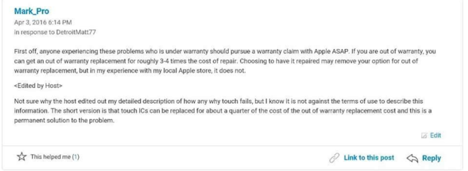

If you follow the ASC support thread titled "iPhone 6 plus intermittent unresponsive screen" you'll see 511 replies to date. The way the forum works is that it is a community-based forum of end users that is only moderated by Apple-employee hosts. Apple reserves the right to delete any post at will for any reason.
I have personally posted the underlying cause of the touch ic failure as described here several times. Within minutes, those posts are edited to remove the information end users deserve about this failure, or simply deleted.
I have been banned twice from posting information to this forum at all, so it may just be that Apple doesn't like me. However, we can see the same ritualistic removal of the same information from others.
Here is my colleague Mark Shaffer's ASC post about this issue, before and after the swift sword of the Apple host's delete key..
