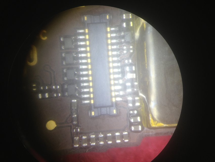

Before---initial view under microscope. Frank corrosion/oxidation at LCD connector.

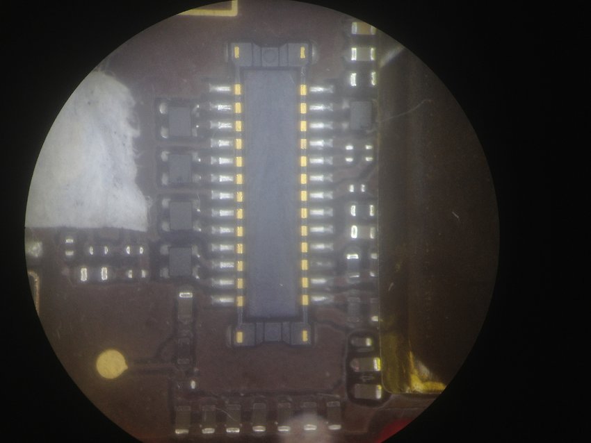

After spot cleaning and ultrasonic cleaning---better, but still a LOT of oxidation...look at third pin of LCD connector--this is LCD input line.

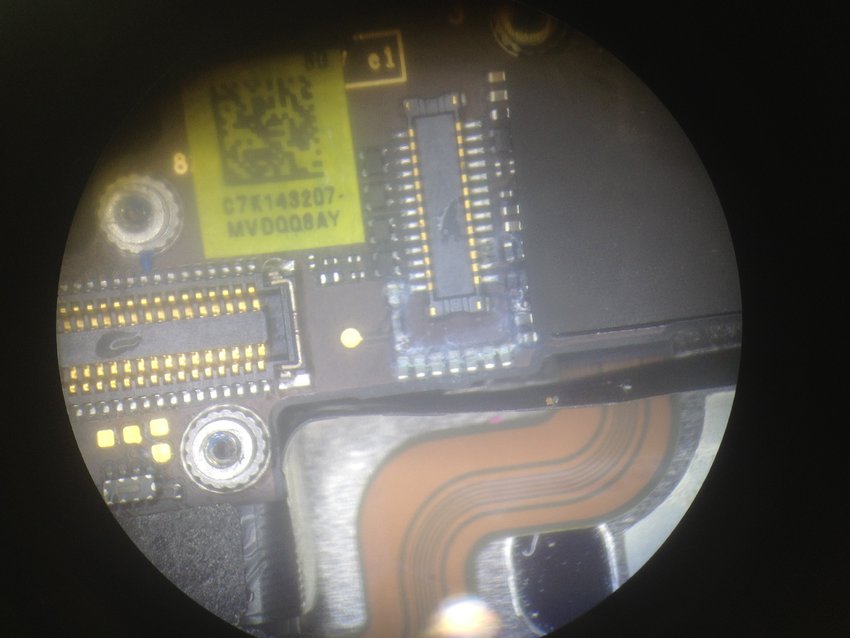

AFTER> Hand reflowing at LCD connector and filters. Notice removal of oxidation at row of components at bottom.---This phone had no display defect.
