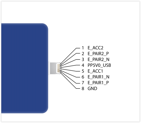

After pressing quicktest, the device will query the dock connector (charge port) lines in diode mode to make sure that it does not get back "OL" indicating an open line between the tester and tristar. If the device does receive an OL then it will FAIL the dock test. This is usually because the dock (charge port) itself is bad in a native device with no prior logic board repair attempt. However, keep in mind that dock test FAIL can also mean that there is an open line at tristar (for example, a prior repair attempt with the chip in the wrong orientation, or not soldered well, or if tristar is completely missing) Dock FAIL can also occur if there is a problem at the dock connector (example, missing pin) or somewhere between dock and tristar (missing/water damaged filter). One thing to keep in mind with dock FAIL is that the tristar tester only works in ONE DIRECTION. That is, the tester can't be flipped around and plugged in upside down or it will report dock FAIL. If you get a dock fail, then you'll need to correct that before the tester can actually have a path to measure tristar. Get a known good dock (charge port) and troubleshoot until the tristar tester can pass the charge port/dock test.
Next, the tristar tester will automatically continue on to test the 8 lines that extend from the charge port to tristar. If the results are all similar to the database of known good values, the tristar tester will report PASS. If not, the device will say FAIL, you can click details to see exactly WHICH lines failed. Then proceed directly to replacing tristar. Or send your device out for Mail in Tristar Replacement.

What actual circuits on the schematics are each of the tristar tester lines?
Each line corresponds to the named circuit as follows:
