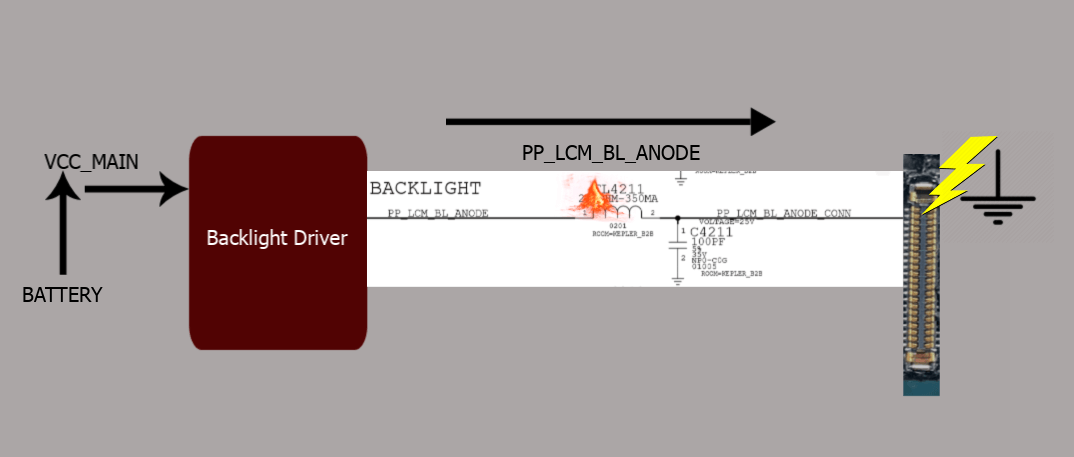

For phone A, we checked the diode mode reading at the screen connector pin 33 for PP_LCM_BL_ANODE_CONN. The normal value of the backlight line, PP_LCM_BL_ANODE, is around 500 (diode mode units-DMU). Our multimeter reading was very high at 1.8 DMU. This tells us that there is open line fault somewhere on the line. The common fault is a failure of the backlight filter, FL4211. A brief look at the schematic shows us that if the battery is not disconnected, then live battery voltage will always be present at the backlight pin--even if the device is powered off! Any transient short to ground during the screen connection process will instantly create a path for electricity to rush through, unregulated. This burst of current will overheat the backlight filter, FL4211, and damage it. Indeed, that was the case with Phone A. We replaced the backlight filter and measured the relative resistance of the line in diode mode---back to normal. So that tells us that the problem in Phone A was indeed technician damage due to performing a screen replacement without disconnecting the battery.

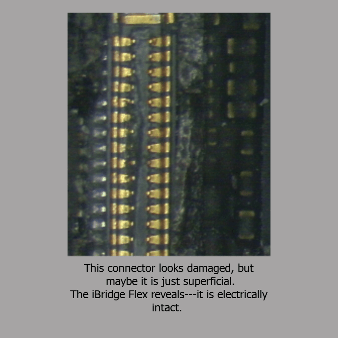

After replacing the backlight filter, it was time to test. But what about the connector on the board--it LOOKS pretty mangled--but is it functional? If possible, we'd like to save David the extra cost of an add-on connector job if we can. This is where the iBridgereally shines. By connecting the iBridge into the damaged connector, we could measure THROUGH the connector. We found that despite the damage, this connector has normal relative resistance on all lines and indeed was functional. Phone A got a new screen installed and booted up working.

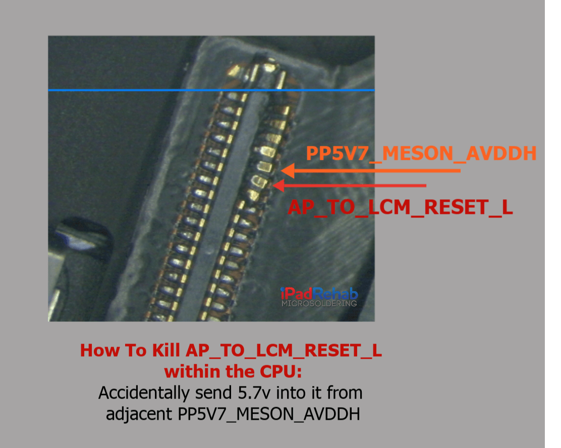

We have seen this same AP_TO_LCM_RESET_L short a few times before. In some of those cases, the history was "This happened right after I accidentally connected an iPhone 6 screen to my iPhone 6s connector" Aha--a clue. We know a little bit about how the screen signals "I am here" to the CPU in the iPhone 6. The iBridge has helped us learn even more by allowing us to study live voltages with the screen connected. Here is arecent video where we learned a little bit more than what we already knew. What we understand is that some voltages, like PHOTON_ALIVE are delivered to the screen connector from the logic board. This voltage asks the screen "Hey buddy, you here?" The screen itself routes this voltage through the screen and back out to the connector and board to signal "Yup, I'm here"
In an iPhone with a short on AP_TO_LCM_RESET_L, the actual location of the short is within the die of the CPU itself. We know that CPUs are brain-like chips made of wispy thin structures for transmitting ones and zeros. It is very easy to electrically damage a CPU. Routing even relatively low voltages into the CPU data lines is like connecting a fire hose to a balloon made of cotton candy. Disaster. So how did Phone B come to have a short on the AP_TO_LCM_RESET_L at a screen change? I think we will get a clue by looking at the actual screen that David was using on Phone B.
That'll do it. And now the entire story becomes clear. David's technician installed a screen on iPhone A without disconnecting the battery. There was a transient short created during the installation when ground momentarily brushed against screen connector pin 33 that always has live battery voltage. This short unleashed a burst of electricity that overheated and damaged FL4211--the backlight filter, creating an open circuit on the backlight line. David's technician tried to troubleshoot why the display was dark by multiple connect/disconnect cycles that ultimately lead to connector damage on both the logic board and the screen itself. After deciding that this 6s was not showing any display with multiple screens, David's tech wanted to know if the first screen was defective, so he installed it on Phone B. He pressed the damaged screen connector into Phone B and hit the power button. The reset line was normal, momentarily, which allowed for the normal activation of chestnut and consequently---chestnut boosted the PP5v7_MESON_AVDDH line to 5.7v. Due to the connector damage, this 5.7v was effectively bridged through the connector and injected into the CPU down the adjacent AP_TO_LCM_RESET_L line. And here is a rare case where we get to legitimately use everyone's favorite board repair term, FRIED. Yes, the likely case is that the 5.7 volts FRIED THE CPU in that spot, creating a permanent short to ground of the AP_TO_LCM_RESET_L line. Now, no matter what screen you install on iPhone B, it will not show any image because AP_TO_LCM_RESET_L is permanently in the low position. This is a situation that we can recover data from with a lot of effort, like in this video. But clearing an internal short within the die of the CPU is not a viable "for the sake of the phone" repair. He's dead, Jim.
