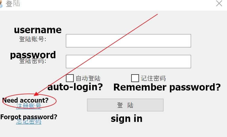

Step four: You will see ZXW3.0 open and prompt you IN CHINESE to enter your username and password. You need to make your ACCOUNT first. Click Need account--the top blue link. This step is the same if you are binding an existing dongle, or setting up a new subscription.
This is the translation (current June 2019)

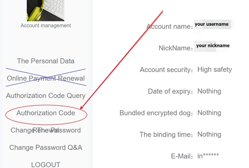

Step eight: You should be here:
Click AUTHORIZATION CODE which will prompt you to enter your LICENSE SERIAL NUMBER and LICENSE CODE that you obtained in Step one.
Note: Ignore the Online Payment Renewal--it requires a Chinese bank account connected to WeChat Pay or Alipay. In China this is how everyone pays for everything. To renew, you can purchase a domestic renewal service to jump through the Alipay hoop. It is not easy for the Western world to use Alipay directly--you will go crazy trying to renew through zxw itself!

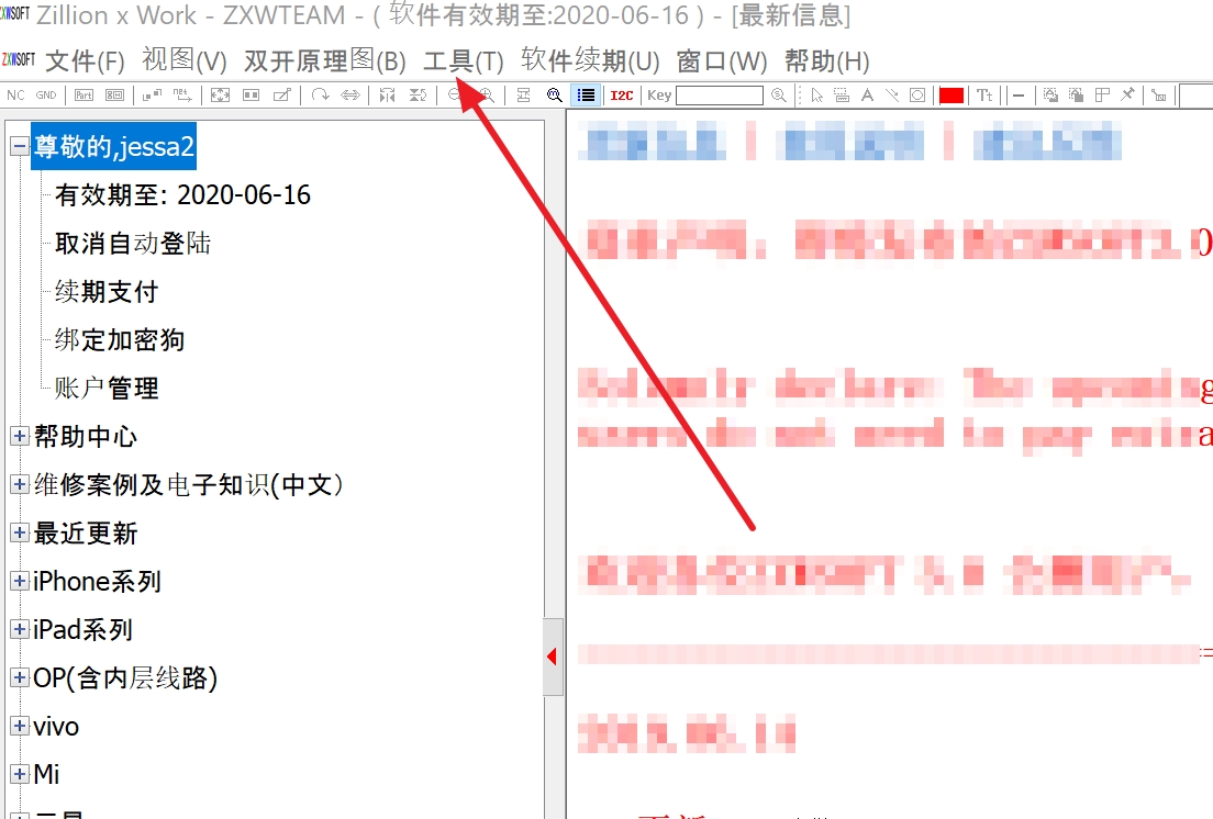

CONVERT ZXW TO ENGLISH! Click T at the top of the zxw software menu.

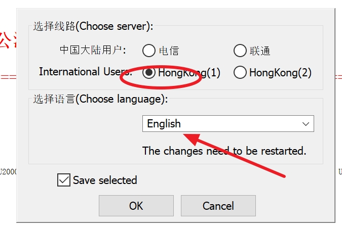

Then click "S" for changing the server. Here you can change the default language of zxw to English, and change the server to HongKong.
Step ten: Close and reopen ZXW to finally be able to use ZXW and Microfish (formerly Blackfish) in ENGLISH LANGUAGE!
