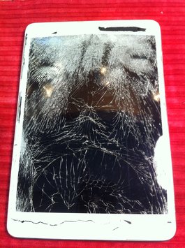

Here is an iPad mini we repaired recently:
This mini was a great little project. Screen and LCD were both casualties in a classic 'I warned you to clean your room or this would happen!" story. This is the kind of mini repair that is a lot of fun---the key to a professional finish vs, a 'watched 2 YouTube videos I got this' repair is getting every molecule of glass and old adhesive off the frame.

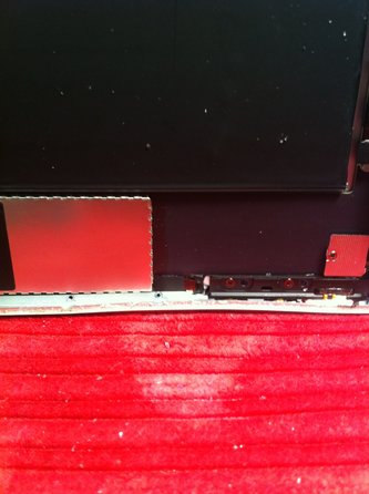

On this one, after the bulk of the glass came off...
It became obvious that this mini had a frank bend in the sidewall of the frame. Oh man.
A bent frame can never accept a perfectly square piece of replacement glass. Here the option to replace the frame itself would tip the price of the repair over the edge of cost-effectiveness.

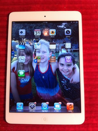

The result--near perfect. The new glass fits completely flush and this mini will live again with its new LCD and digitizer---all for less than the cost of replacing the device.

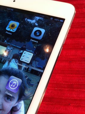

Beautifully straight reshaped sidewall:
After: This mini is hard to distinguish from new.
