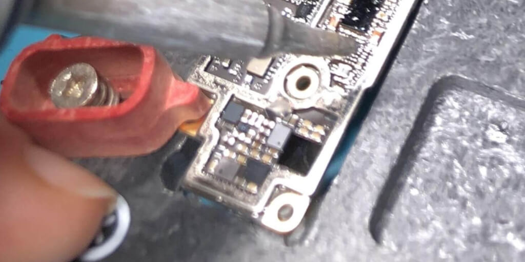

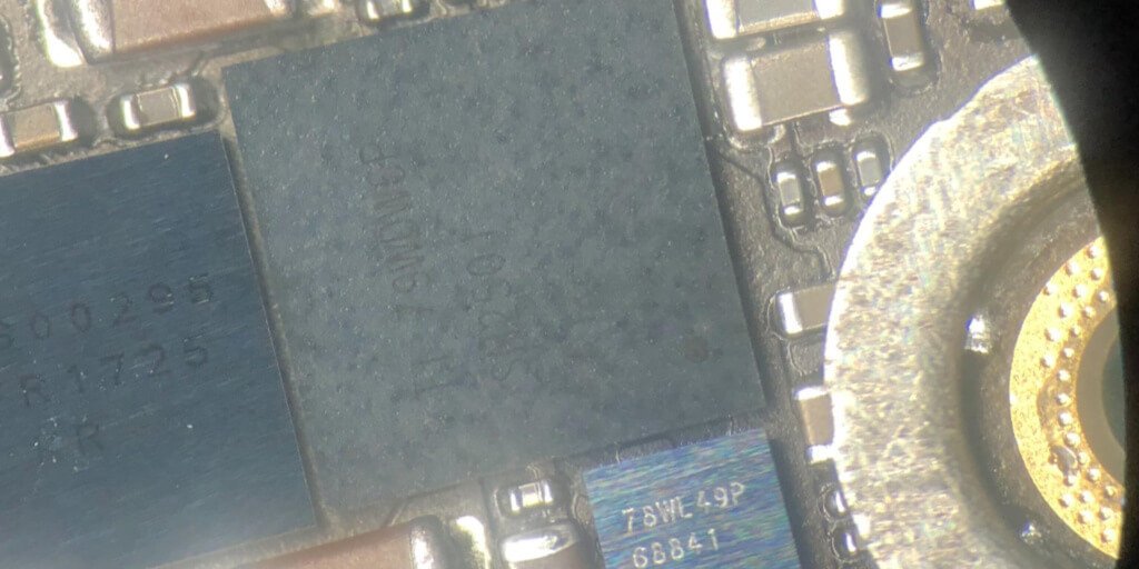

For this dead iPhone 8, the next step was a detailed microscope examination of the logic board. We found that the logic board had no significant deviation from normal. We then proceeded to an electrical examination. From the 5v0 USB voltage input, this phone would consume only 0.36 amps. This is quite low, but not zero. It was a clue. From the 4.3V battery voltage input, the phone would consume even less. Another symptom. A pattern begins to emerge.
What could be causing this low current draw on an otherwise physically undamaged phone?
What disease presents this way? The art of logic board troubleshooting for data recovery combines the skills of an experimental scientist, a physician, and a detective. iPhones typically fail for a reason rather than randomly. In this case, the most likely mechanism for the death of this iPhone was charger damage. Most users are never taught that the iPhone lightning cable has a surge protector chip buried inside the cable. This protection chip is missing from "gas station chargers" which are ubiquitous. In turn, damage from chargers is a very common mechanism for failure in a phone with no physical signs of injury.
From our experience, we found a pattern recognition match between the physical and electrical presentation of this phone, and ones that we have solved before. We knew that damage to the tigris chip on the logic board can cause a phone to fail in the same way as our case phone.

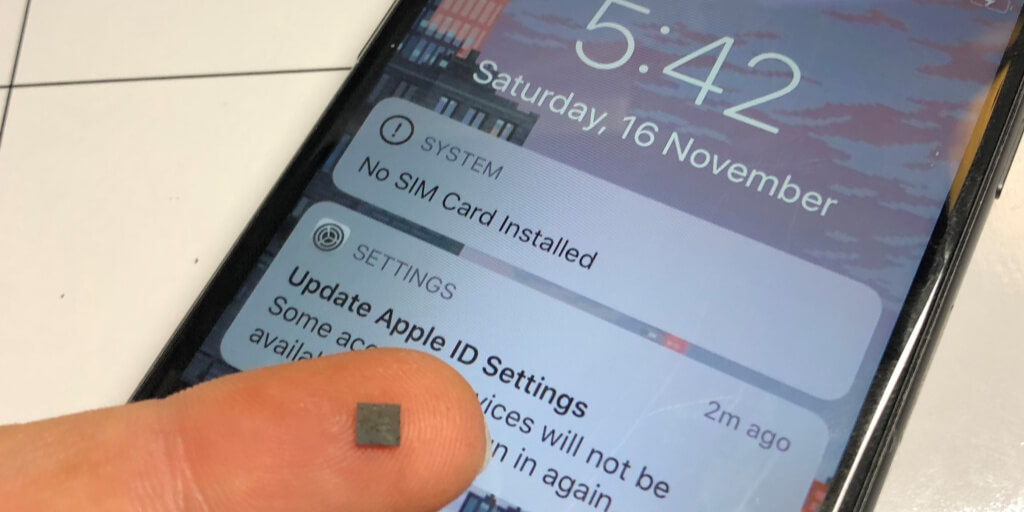

The next step was to replace the tigris chip on the board to test this theory. With a brief microsurgery, we used hot air to melt the solder and remove the pea-sized tigris chip from the logic board. The pads were cleared of old solder with an iron, and a fresh chip was installed.
We were pleased to see that this phone booted right up in the test jig.
We were able to enter the passcode and decrypt the data. With a usb connection we could offload all of the pictures, videos, notes, messages, contacts and a full iTunes backup to a usb drive. For this iPhone 8, the logic board had only had a single chip failure that had been completely solved during the data recovery investigation. After getting a full data extraction, we reassembled the now-repaired logic board into the housing it arrived in. Pleasantly, the logic board was now able to charge the native battery and "be a phone again" after recovery. This family will be receiving their data extracted and parsed to a usb drive, and as a bonus they will be getting back a working phone!
