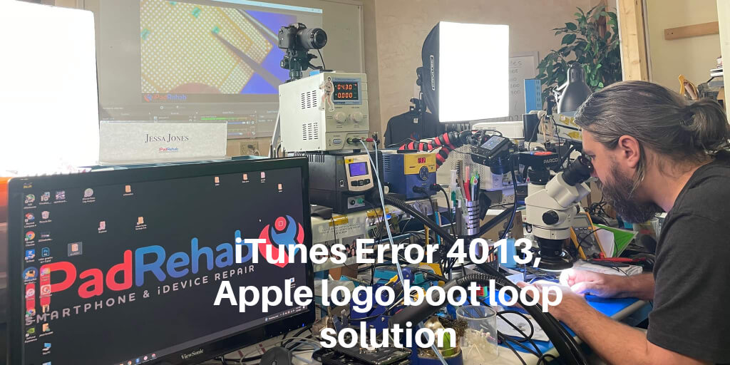

You can watch how we do this surgery on our iPad 7 CPU reballing video here. With years of experience microsoldering copper wires smaller than human hairs, Mark makes iPhone brain surgery look easy. However, only a handful of craftsmen in the US have developed the highly specialized skill of iPad and iPhone CPU rework.
