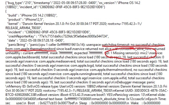

Method 2: Use the Panic Logs
A more precise method to determine which sensor circuit is the problem is to read the panic logs. The panic logs can be retrieved either by:
  1. Navigating on the device: Settings→Privacy→Analytics&Improvement→Analytics Data then scrolling to the panic-full logs.
    1. Using 3utools or similar third party software and selecting “Crash Logs” and opening the panic-full logs.
With each new phone and iOS updates, the specific phrasing the panic logs use to describe sensor errors can change over time, which makes simply having a look at your panic logs a great strategy. Look for keywords such as “thermalmonitord” “temperature service” “temp” “watchdog timeout” “sensor” to help you find where in the log the missing sensor fault occurs.

Working Guide to iPhone Thermal Sensor Panic Log Data:
Which sensor circuit is which? Once in the logs, the names of the sensors themselves can be a bit cryptic. Here is a working guide to help you match your problem sensor to the problem part.
Remember: DIFFERENT PHONES REQUIRE DIFFERENT SENSORS. iOS UPDATES CAN CHANGE REQUIRED SENSORS OR THE PANIC LOG LANGUAGE. This is a working list that will change over time.
PROBLEM SENSOR PART
LOG MAY SAY
Charge Port
Mic1, Prs0, 0x800, 0x40000, 0x100000, 0x300000, 3145728
Battery
Gas Gauge, TG0v, TB0v, TG0B, 0x4000, 0x500000, 0x41, 0xa1
Power Flex
Mic2, 0x100000
Front Top Screen Flex (proximity/als)
0x1000, 0x80000, 0x200000
Wireless Charging Flex
0x200000, 0x400000
Sandwich Board Issue
0x400, 0x20000
Prox Flex, Power Button
0xc0000
Charge Port, Power Button, Prox Flex
0x1c0000
