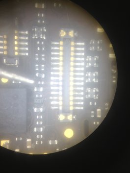

BEFORE
This is typical iPhone 5 corrosion at LCD connector. This phone will not show a backlight. The corrosion was very focal--just here at the backlight, digitizer and front camera connector

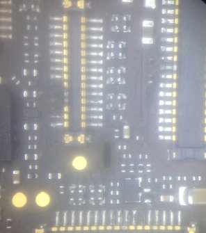

AFTER JUST CLEANING
Better, but not good enough. The frank corrosion is gone, but clearly this LCD connector is too oxidized to make good electrical contact if at all. The digitizer connector will probably work, but would be better to just flow that touch of corrosion right off.

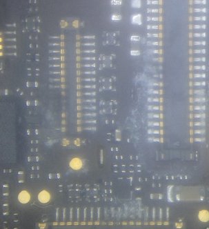

AFTER REFLOW
Practically unscathed. This connector is restored and the backlight is back on. Digitizer and front camera connector also look great. See needle pointing to a tiny connector that has been reflowed as well.
