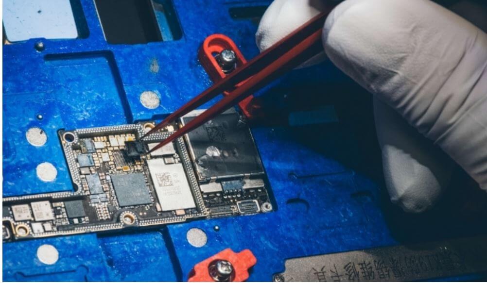

Image from Drivesaversdatarecovery.com Nov 2023
This is an image featured publicly on Drivesavers iPhone data recovery website. The photo is of someone working with the baseband power management chip on an iPhone X. This chip is not required for the iPhone to boot for data recovery. In fact this entire lower board of the iPhone X does not contain user data and is irrelevant for iPhone data recovery.
